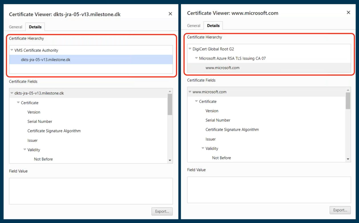

  • How can you tell if a certificate is self-signed or from a CA? If you look at the details of a certificate, the history won’t be very long for a self-signed certificate. In addition, there won’t be any centrally trusted source listed. In the below side-by-side view, the certificate on the left is self-signed and the one on the right is from a CA.
