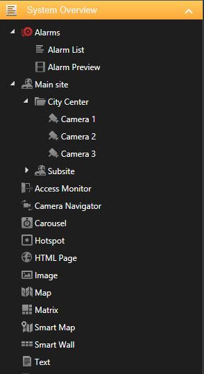

Content inside views (explained)
Once you have set up the view with the layout you prefer, you can add different types of content to your view items. In setup mode, you can drag and drop these items from the System Overview pane into the view item.
- Alarms - the alarm list and alarm preview you can also find on the Alarm Manager tab.
- Cameras - video feed from a live camera or video played back.
- Access Monitor - with XProtect® Access installed, you can set up access monitors, for example for a specific door.
- Camera Navigator - allows you to navigate cameras on a map.
- Carousel - shifts between cameras and at a pace that you define.
- Hotspot - a hotspot window shows whatever camera is in focus in a high resolution or framerate.
- HTML page - import a webpage into the view, for example the web address of an online news channel.
- XProtect LPR (add-on) - with XProtect® LPR installed, you can add LPR cameras to views.
- Image - allows you to share images, for example of suspects.
- Map - a floor plan or a geographical area.
- Matrix - add a Matrix position to a view. For more information, seeMatrix (explained) .
- Smart Wall (may be an add-on to your system)
- Text - add text to you views.
- Transact (add-on) - add point-of-sales systems together with cameras.
