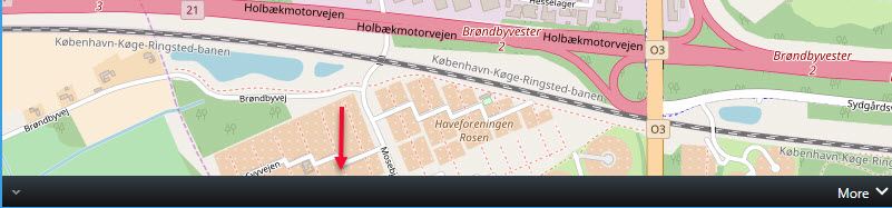

  3. At the bottom of the smart map view item, click the black bar and drag it into the view item that contains the Smart Wall overview.
    sc_smartmap_send_to_smartwall
  4. Select the appropriate position inside the Smart Wall overview.
