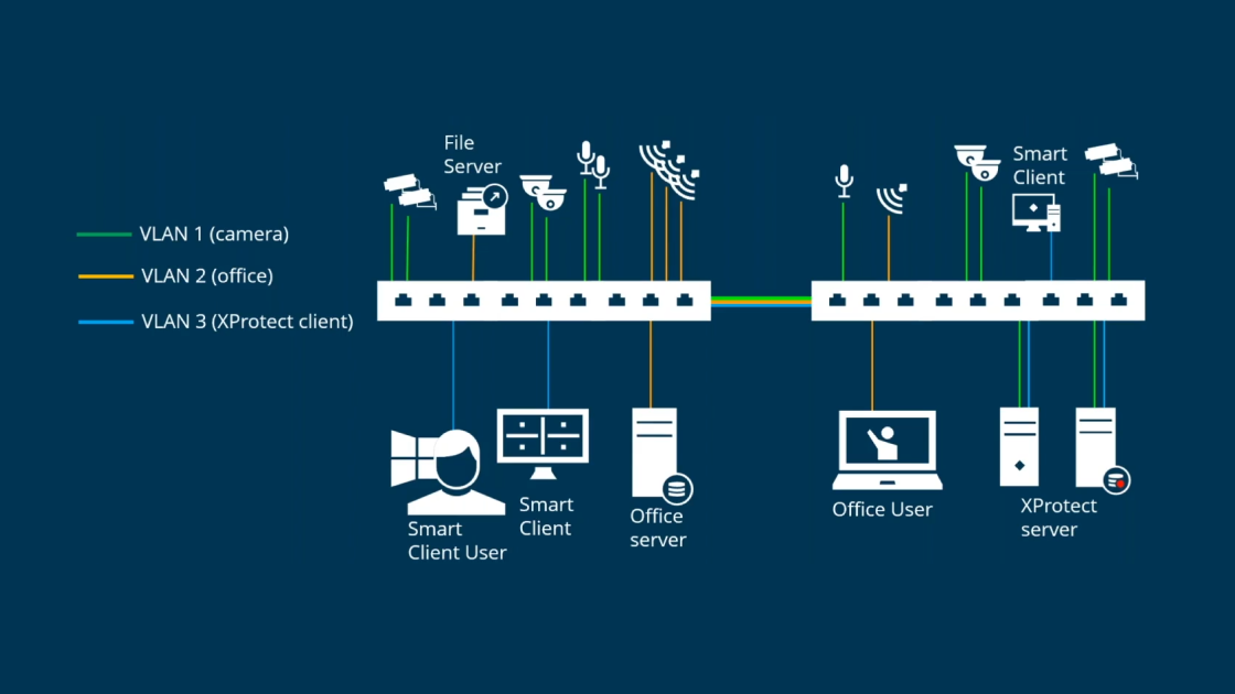

Do I really need separate VLANs for my cameras and my video management clients?
Yes. Even if your cameras are already blocking internet access, you should still put them on their own VLAN.
Here’s why:
  • It’s safer. Separating cameras from VMS clients reduces the risk of unauthorized access to the camera feeds. If one VLAN is compromised, the others remain protected.
  • It helps ensure decent network performance. Cameras typically generate high amounts of data traffic. Isolating this traffic on a separate VLAN ensures that it won’t interfere with the performance of the VMS clients and other critical applications on the network.
  • It makes troubleshooting easier. It’s easier to identify and isolate network issues when different types of devices are segregated into specific VLANs.
You can create the camera and client VLANs with a managed switch and configure both to “talk” to your VMS server. Security operators can view camera streams via this secure communication. Here’s an example of what this setup looks like:
