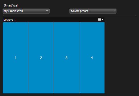

- The Smart Wall has its own view item inside a view. What you see is the graphical presentation of the Smart Wall, not the video content.
To view the contents, you need to send the Smart Wall to a separate window, either on your main computer monitor, or to secondary computer monitors. For more information, see Send Smart Wall overview to view .

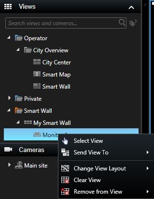

- The most direct way of viewing the Smart Wall content is to access the Smart Wall directly from the Views pane. In doing so, the Smart Wall content is displayed immediately in the viewing area in XProtect Smart Client.
If you want to review Smart Wall content without disturbing what others see on the video wall, you can click the Disconnect Smart Wall monitor button. Changes you make will not affect the shared view. At any time, you can reconnect to the server.
